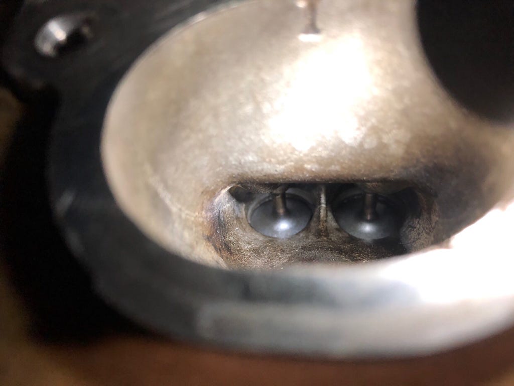

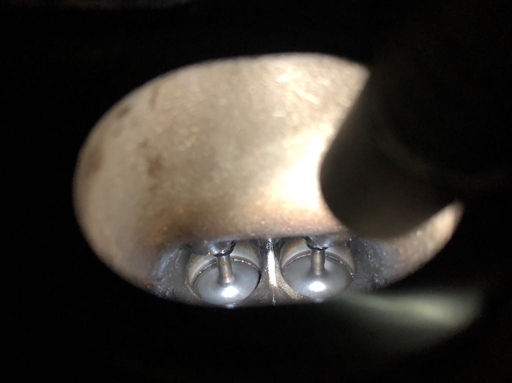

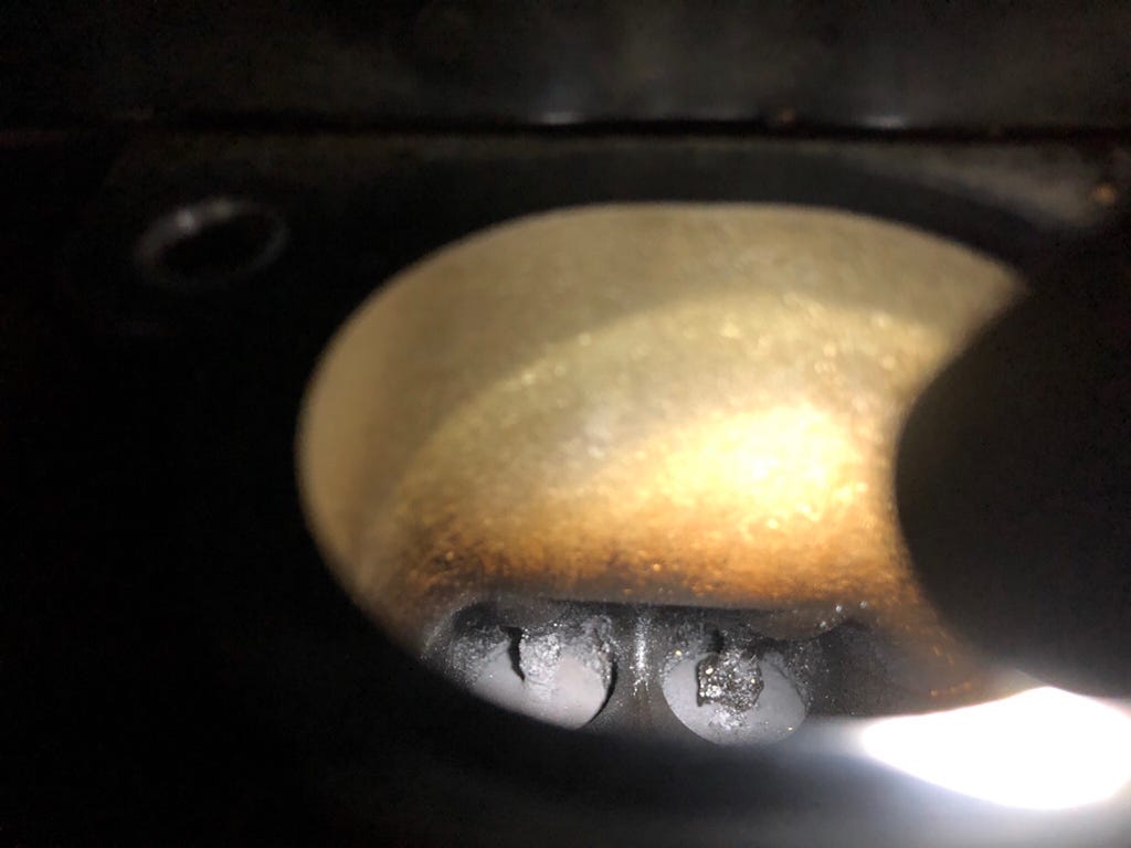

I removed the intake manifold and below are some of the before pictures:
At first I didn’t think it looked that bad but after looking closer I noticed the some of the valves had a thick layer of buildup and on some the had a thick ring around the edge of the port and others that had large globs of carbon on the stem.

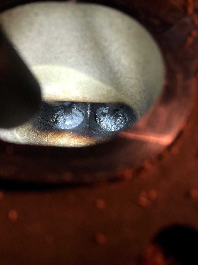

It took a lot of work to get the carbon off, the blasting itself would not do it all, I had to scrape and scrub the valves to finally get through. I would blast for a few minutes, spray CRC and let it soak then scrub with a brush and blast again. After about 6 hours I had all valves cleaned. The amount of work it took to get the carbon off I do not see any way that spraying valve cleaner in the intake alone could ever get the valves clean. Below are after photos:
Make sure to identify what cylinder has the valves open and tape that one off. Once the other 5 are clean, bump the starter to close the valves in that cylinder and clean that cylinder. Be sure to clean all cylinders out very well before rotating the engine so you do not suck in any wall it shells.
