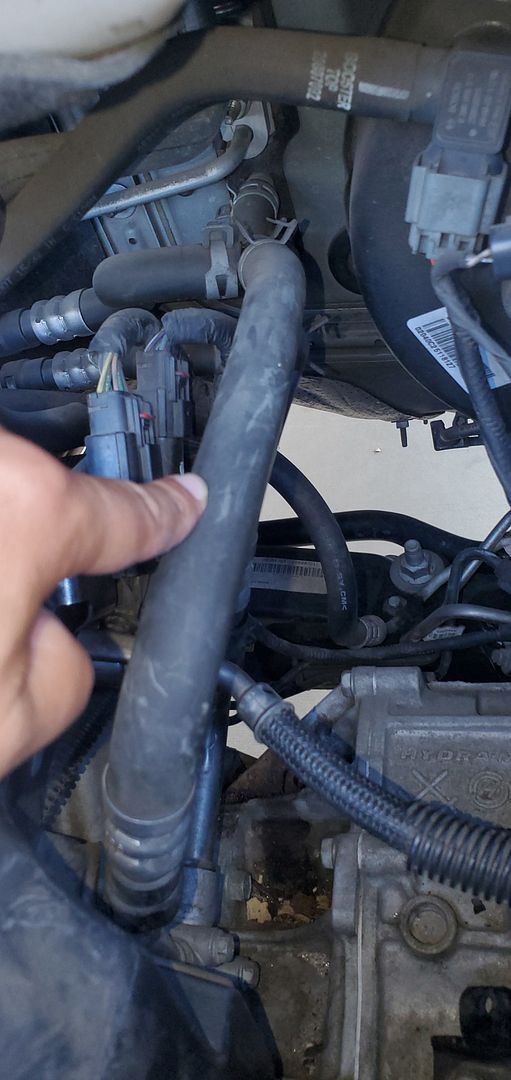

Also check the coolant hoses for the heater core.
These are close to the brake booster/ firewall.
The connectors are hard plastic that can crack and leak.
2
Check the connections on the connectors of this hose
See less See more
