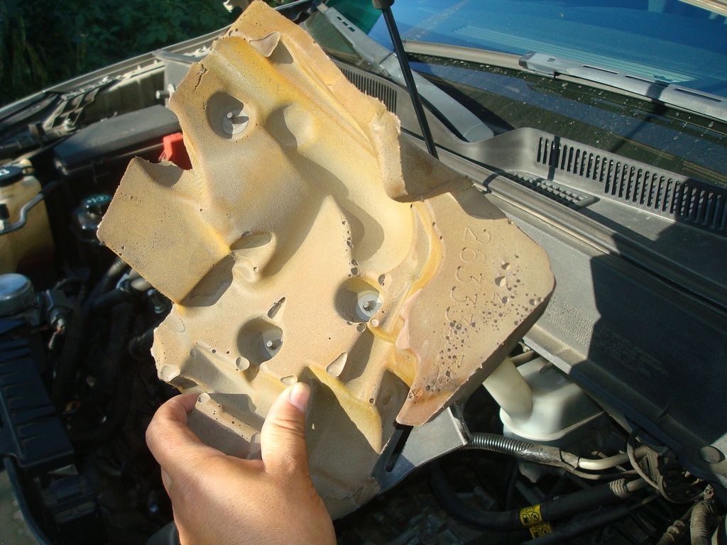

You need to remove the black shield up front. Since the fasteners are recessed, I recommend you use one of these paint can /bottle cap openers- sometimes given away for free at Home Depot---- that’s how I got mine.

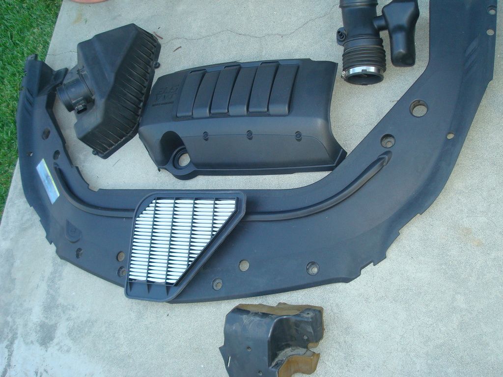

You will remove the black shield, the engine cover, the throttle body tube, air filter cover, and High pressure fuel pump foam cover.
This took me about 15 min.

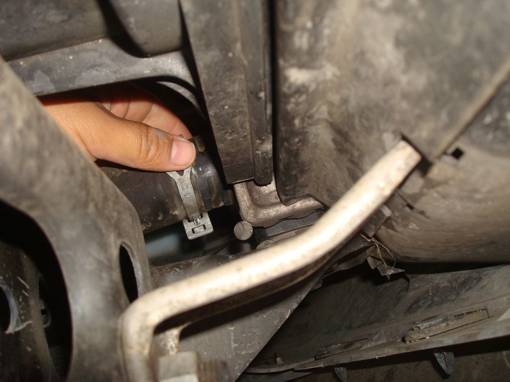

This is the view from the bottom of the vehicle—looking up-
Ive attached the clamp tool- and squeeze.
Once the clamp is loose- I move it back and stick my arm up and pull back the hose. This one slipped off pretty easily.
Have you container ready to catch coolant.

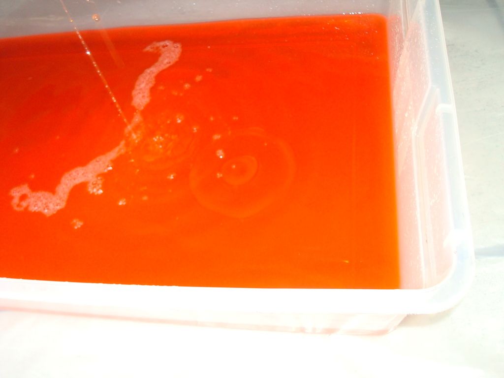

Very clean and clear coolant came out.

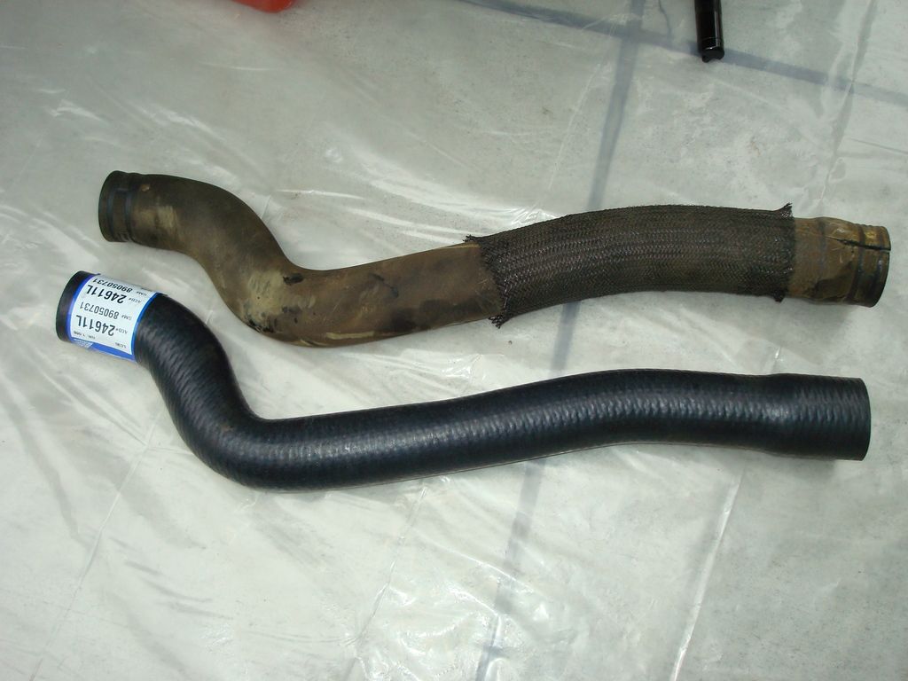

Remove and replace the UPPER hose.

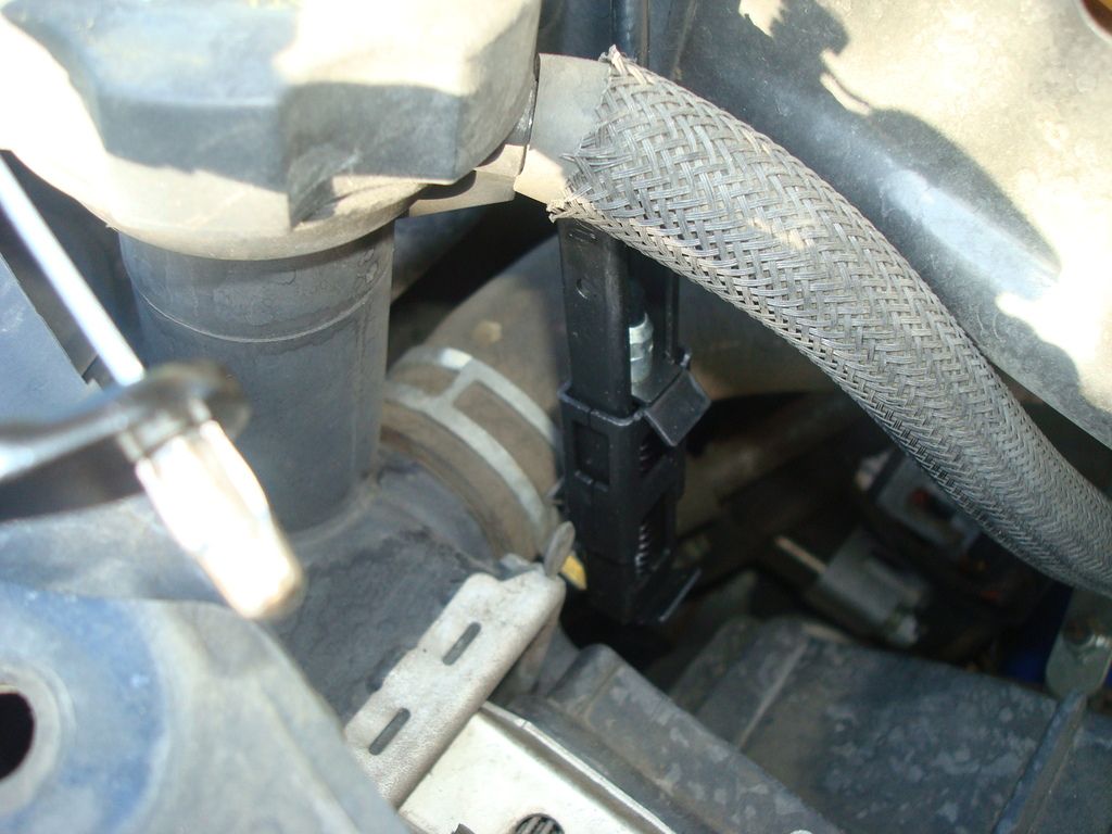

Use the tool to loosen the clamp closest to the radiator.
This hose also easily slipped off.
Now use the tool to remove the REAR clamp- right next to a motor mount. Tight fit- but can be done.
This hose was not going to slide off like the other. It was stuck on.
Since I was replacing it- I simply used a razor blade and cut a line- then used a screwdriver to pry it apart and help unstick- and it came right off.
Then pull the hose out of the opening.
I transferred the sleeve and put the new hose in. Reverse procedure.

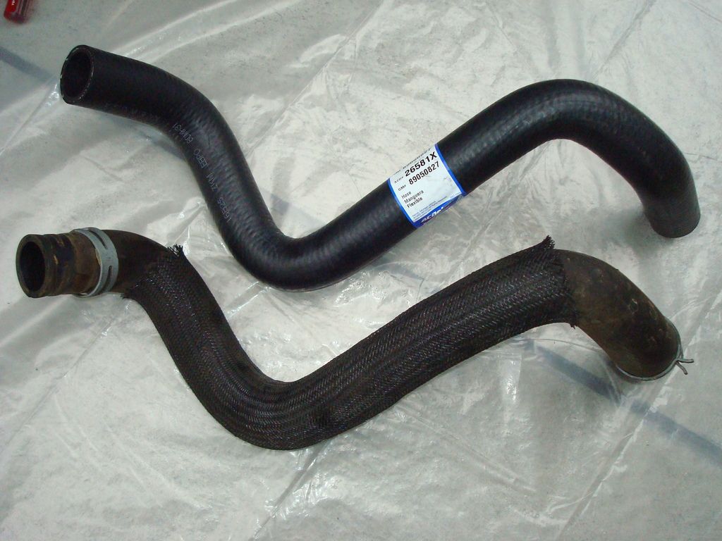

Loosen clamp on hose attached to thermostat
Since the hose is hard to pull off- and the hose will be replaced- I simply cut.
NOTE- take note of the hoses routing.
Also take note how one end is shorter than the other end.
Remove the old hose- transfer the sleeve.

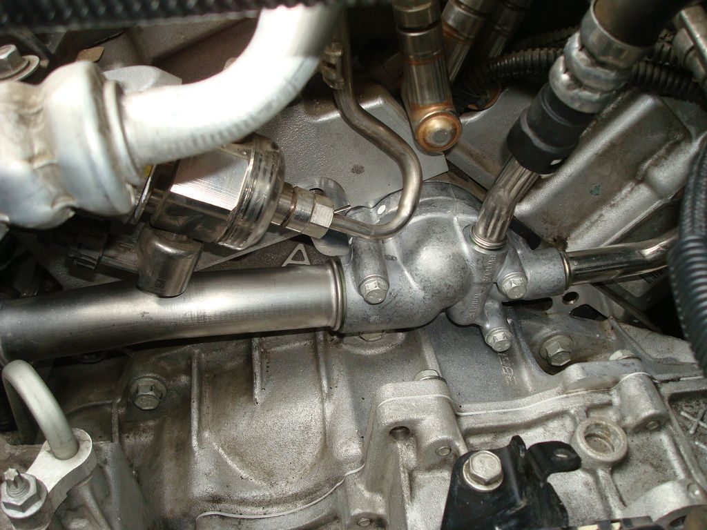

Thermostat.
At this point- slide your coolant container towards the rear----
The thermostat will also have 2 other connections in the rear.
I Used pliers for this.
You push down on the hose- and at the same time compress the clip- and then pull up.
Easy as that.

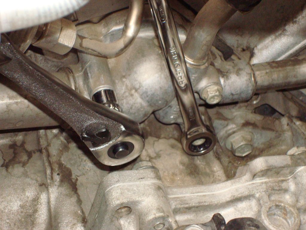

To loosen the thermostat- 4 bolts need to be removed.
There is a bolt that has to be removed- located where the ratchet is shown….
There are 3 bolts holding the thermostat at this point.
2 can be removed with the ratchet- the 3rd one as shown- as the ratchet hits the side of the transmission.

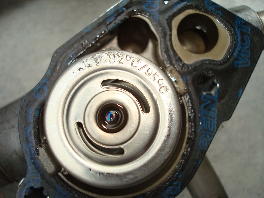

Once removed- the old and the new.
Transfer over the clips. Carefully pry and push up- using a screwdriver.
(try not to break them).
The old thermostat. With the factory gasket.
Note the temp readings.... the same is stamped on the new thermostat.
82/95 C. (179.6/203 F)

yes, it is nice to see the coolant come out 'crystal' clear (red/orange) of course-- but no crud
