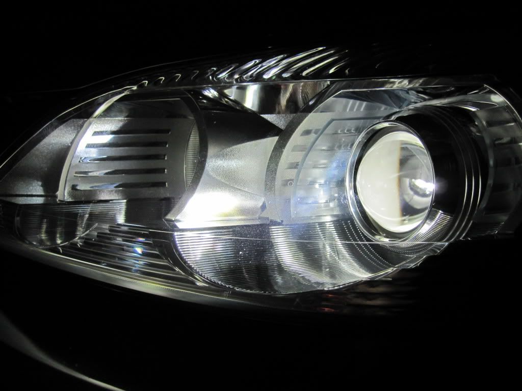

I woke up this morning with one thing to do, install my new HID lights. I started about 10, after some issues around 3 I had ONE side done! I LOVE the way they look and I am very happy with it. Tomorrow I will finish and post more pics. I went with H11 bulbs 6000k. Tomorrow will not take long to do the other side, now that I know what I am doing. If I had to do it all again, I'm sure I could do it in about two hours.

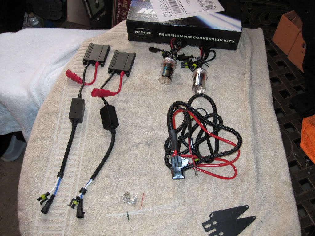

Here is the kit before I started.

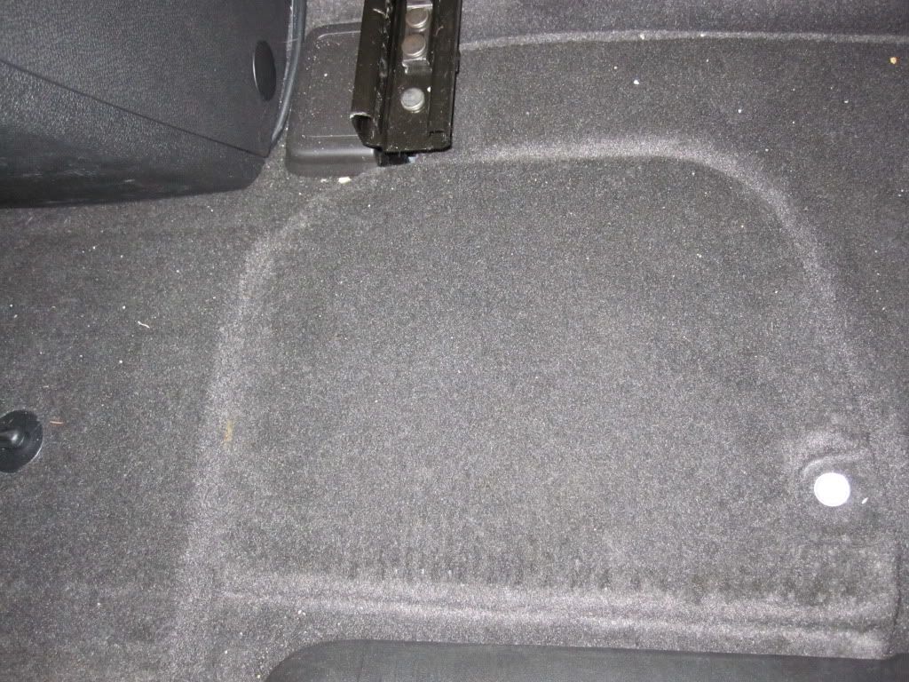

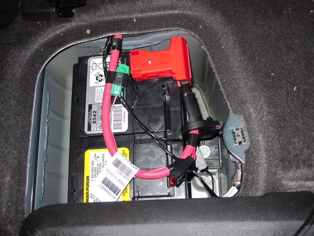

First thing I did was disconnect the neg battery terminal located behind the passenger seat. Easy enough, you need a hex screw to remove the floor piece. Had to really pry at the the neg connect as it was really on there.

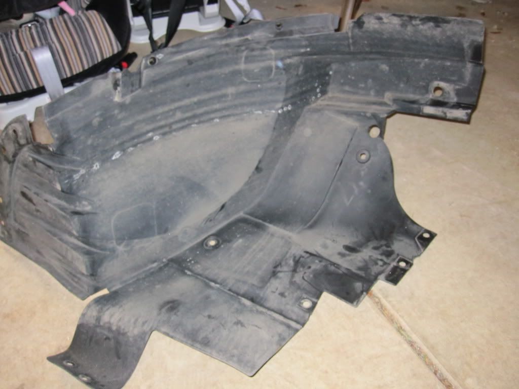

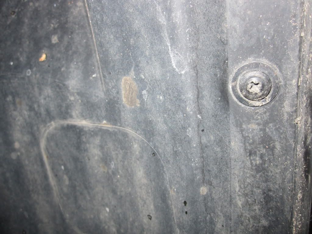

From there you have to remove the inner fender... VERY time consuming. I did not remove the wheels as I did not have jack stands. That would have made this install about 10 times easier, however you can turn the wheel all the way one direction and get in far enough. There are 4 screws (two of which are under the air dam), and 9 push clips that need to be removed. To remove the push clips you first remove the inner cap with a flat screw driver and they pull out the back with plyers. 4 of these clips are under the air dam so you have to get under the car.
Here it is removed and on my garage floor (sorry the car is dirty and the garage is dirty!

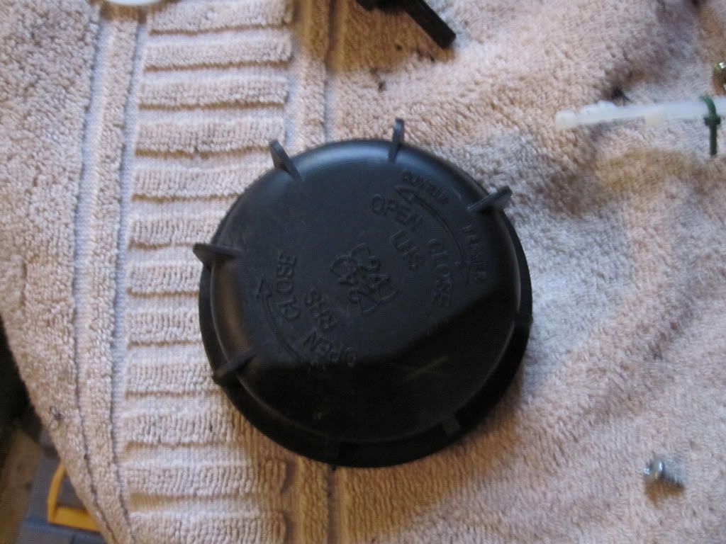

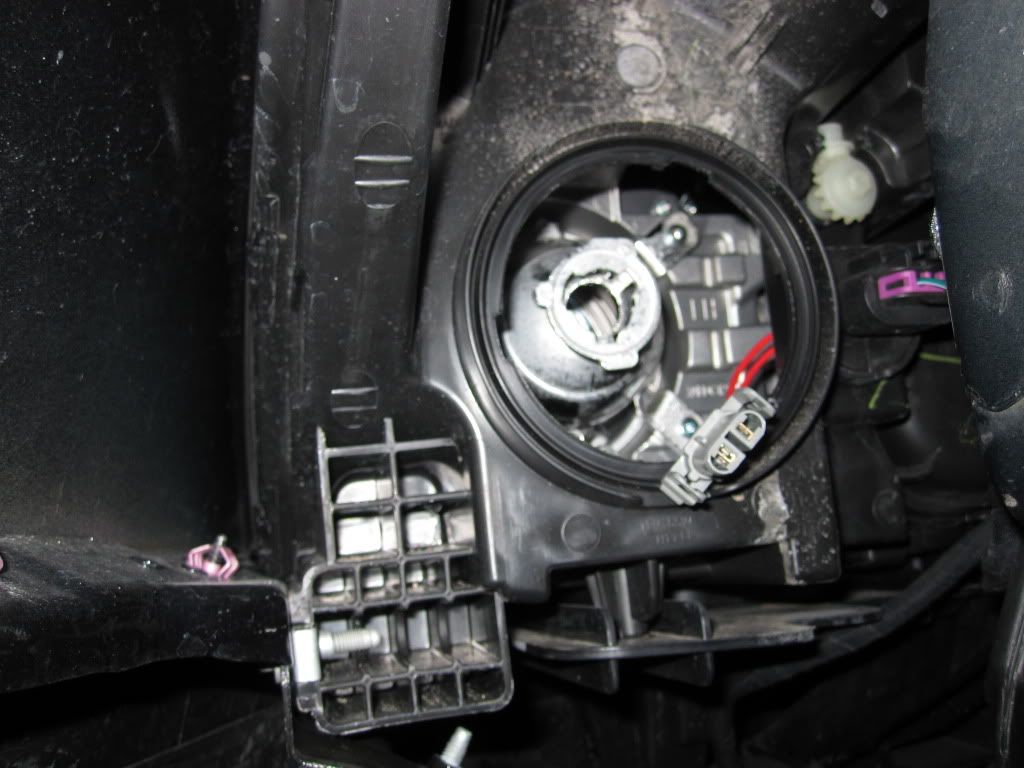

Once off you can get to the light rather easy. You will see the cap that you simply twist off.

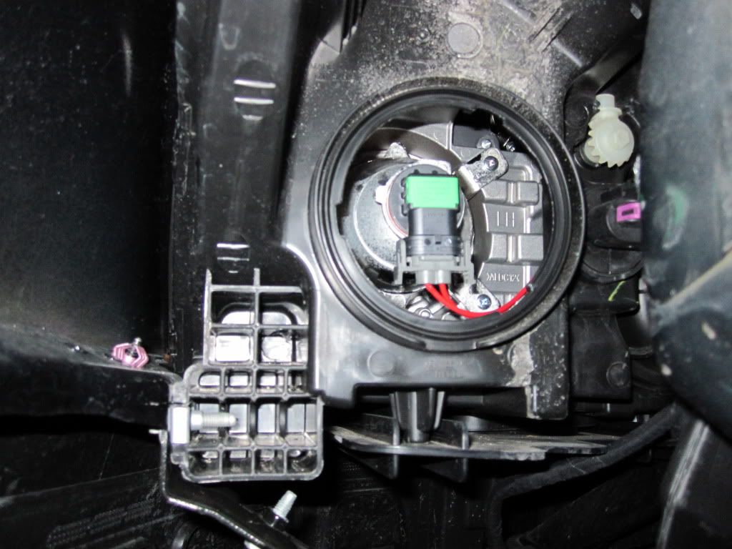

From there remove the stock bulb, again twist and it will come out, then unplug.

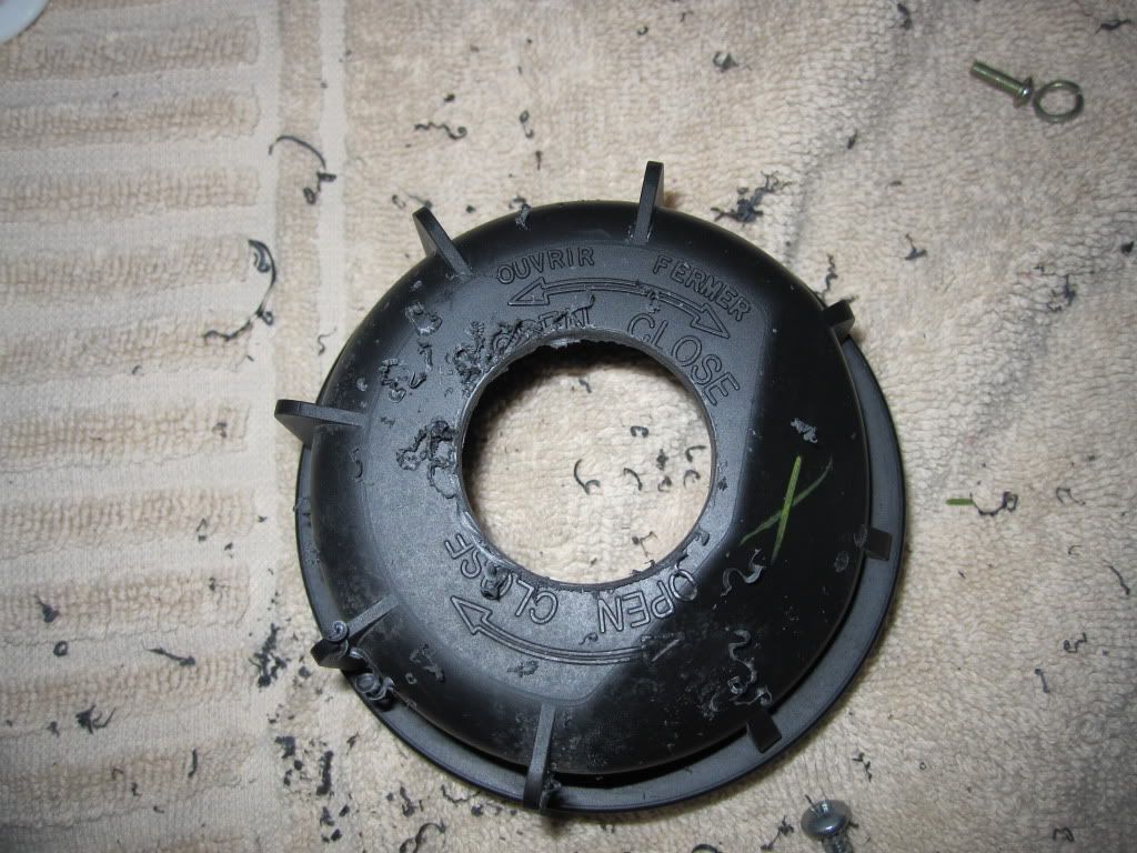

You have to drill into the stock cap inorder to allow the light and wires to pass through. Not a big deal, I think my drill bit was 25mm. The rubber seal they provided fit nicely, however I am going to go get some kind of rubber sealant to make sure it is water tight. I will post pics of the cap with the hole I drilled tomorrow.

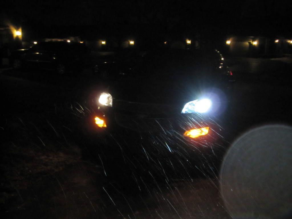

Here are pics. As you can tell the driver side is HID the passenger side is stock. I will add a ton more pictures tomorrow after I finish the install. I am 100% saitisfied.

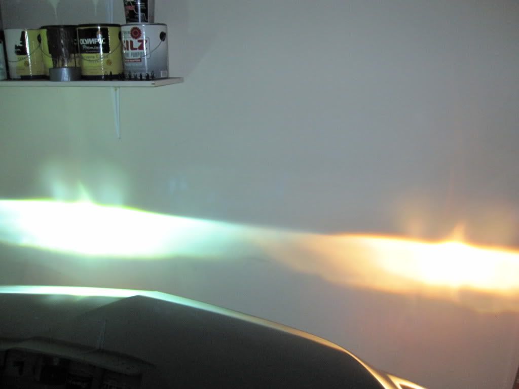

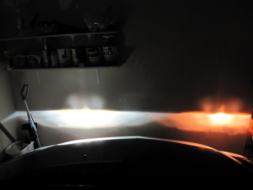

In the garage, not sure why the stock looks so orange in color, camera must have pulled alot of color from the front parking lights. You can see the cutoff line remains the same and inline with stock.

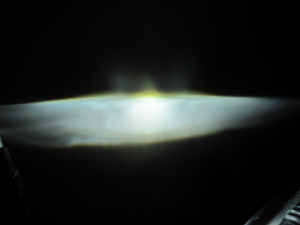

outside, it is snowing a tad. I will post better pics.
I will post more pics later tomorrow. Showing where the screws are located, where I mounted my ballast and how I ran the rely from the battery terminal. I could not find any step by step instructions on the web for installing a traverse HID. I did see one on the Acadia, however it was a tad off, but still very helpful. We have more screws and pins in different locations. I would not suggest installing HID if you dont have an 09 LTZ as these have the projector lights. If you do have the 09 LTZ or you install those lights I HIGHLY suggest this upgrade, in my opinion anyway.
I went for a quick drive, the difference is simply amazing. I also had the wife drive it towards my car, it was not blinding at all and you could 100% tell they were true HID not just bulbs. I also love how when you start the car they fire up, looks cool. I will try to remember to turn off the running lights as I dont need the HID's running during the day.

I would guess that the color difference of the pictures comparing new/stock lights were caused when the camera set the exposure based on the new light's brightness and whiteness, making the stocker look orangish. I'd imagine a picture of two stock lights with the same camera would appear white.

Chevy 2011 with Projector Beam Lens
Dear Tiestosteele,
I have recently bought Traverse, and just installed Head lamps with Projector Beams ( 2009 Model), now when I installed the HID Kit, I noticed that the light has been aligned on a stright line, but there is little light comes above this line, so is this case normal?
I noticed that this case is the same as your car, so I just need you advise in this issue...
