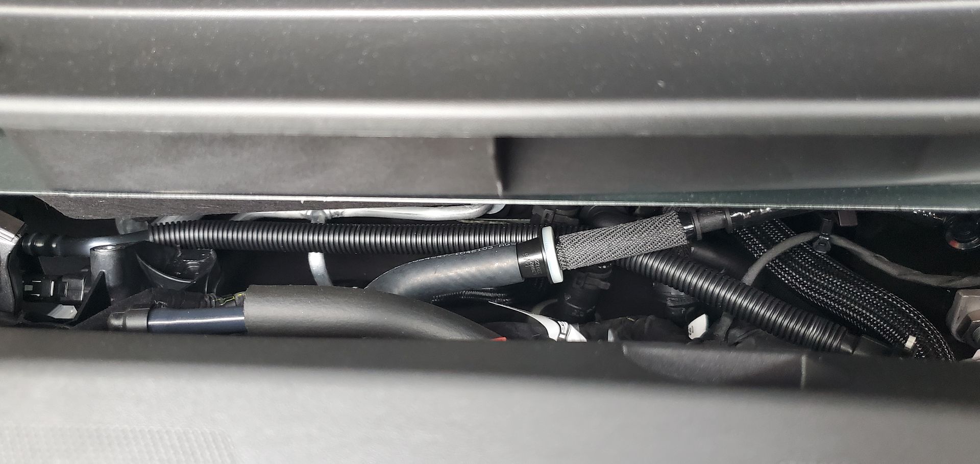

Based on the pic online doing a search on the sleeve part #...
It is just a foam sleeve.
Im thinking buy foam sleeve yourself and zip tie it in place.
Xltbest, can you post pic of the finished work?
You know, sometimes you as the owner can be gentle and kind to your vehicle vs the lowest guy on the totem pole doing this install.
Like when they did the wiper recall on my equinox. Wipers were way off... actually wiped off the glass on the drivers side.
I had to pull and reseat the arms in the proper location.... vs taking it back and waiting.

That looks easy to do.
When my 2023 arrives, ill see if theyve implemented this.
If not, ill do it myself.
Looks like foamy heat resistant rubber.
Based on the tsb, its placed at 2 spots. Those are probably the natural frequency points that help the tick be louder.
I wonder if simply wrapping electrical tape at those positions would change the natural frequency enough to quiet it.
Hmmmm.
Ohhh, xltbest... thank you for posting that pic. Very helpful.
Heres an image of the part.
See less See more

Exactly how i see these working.
