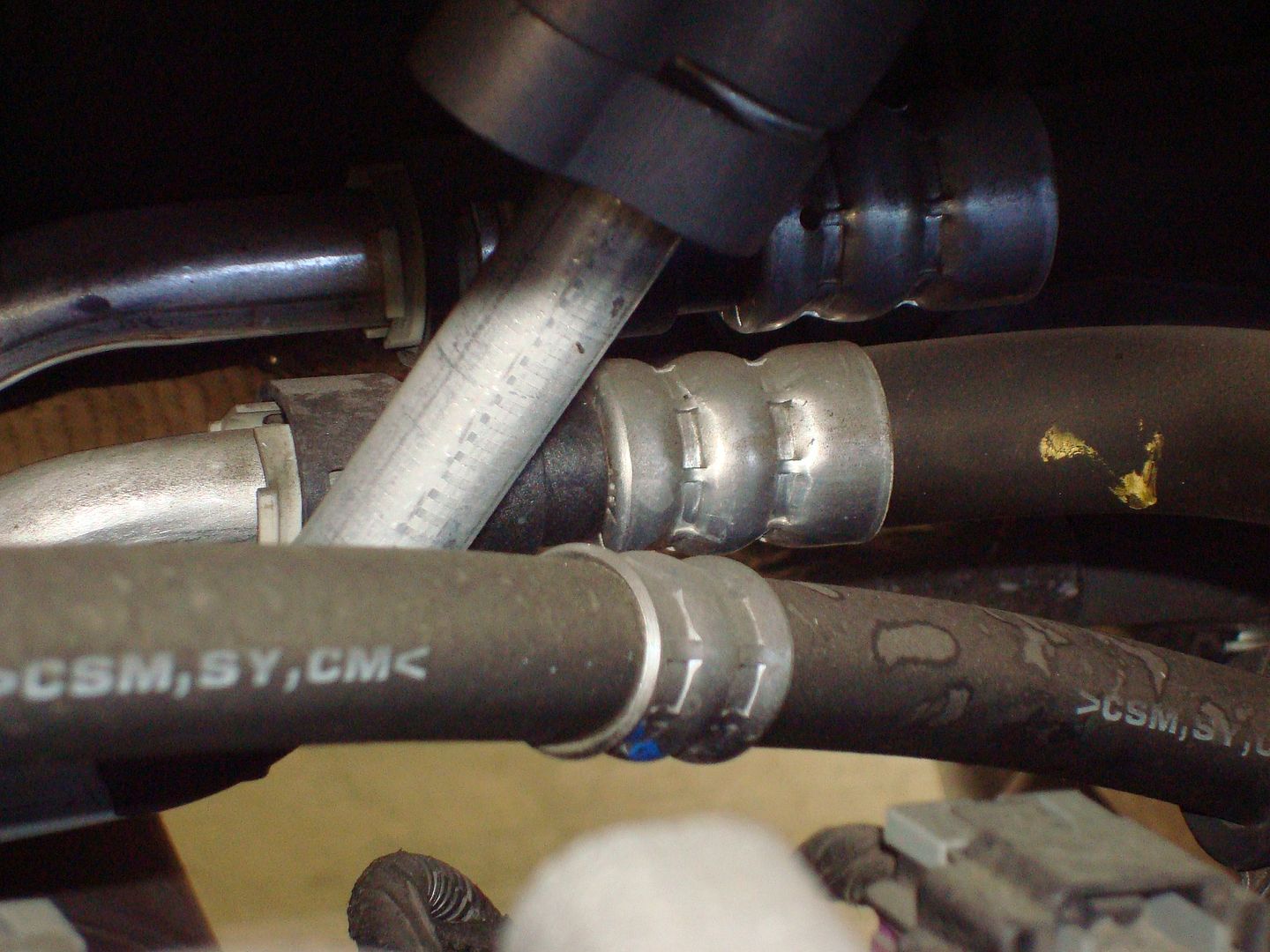

It appears the brace is attached to the hose on yours------ but check to see if its attached to the engine.
I snapped from underneath the car - and looking up between the firewall and engine.
The hose that did the rubbing- is supported by a brace that attaches to the engine.
If someone worked on your vehicle- they may have left that off- or put it back in the wrong position?
On mine- there is plenty of space.
im wondering if you do find your brace is loose or not attached...
that you can say-- hey-- this is installer error....
give me a price break.....
on this thread - I posted pics on post # 26.
of what my hoses look like--
this is between the engine and the firewall.
Some folks- these hoses rub- causing wear on the hose and eventual leak.
There is another post where someone posted a pic of the actual wear on their hose... may be another post on here
