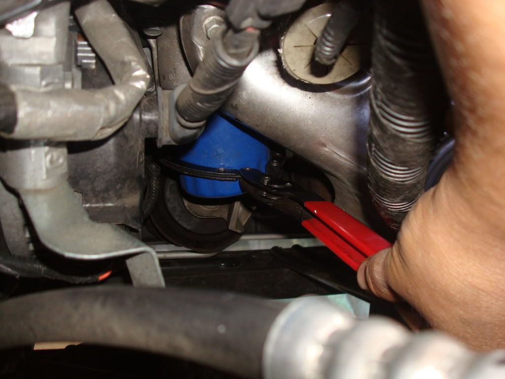

someone recently postes a pic-- of their AC hose being cut/slashed.
turns out that they had engine work done-
by the alternator- theres a bracket-
during the repair- the bracket was put back at the wrong angle-- and it essentially left a sharp edge on which the AC hose over time was rubbing on...
and well cut into it.
The op posted a pic of his bracket-- and I posted a pic of my bracket-- you could clearly see the bracket was at the wrong angle on his.
This was right by the alternator.
Posts: 9212
« Reply #3 on: May 24, 2013, 10:36:03 AM »
look at the bracket- and compare to the GND stamped on the metal..
this where yours leaked?
his
mine..

After looking at rbarrios' excellent (as usual) pictures, I'd say somebody in that case moved to bracket for better access to the oil filter, and forgot (neglected) to put it back where it belongs!!
2015 2LT
Posts: 9212
« Reply #12 on: May 31, 2013, 10:21:30 AM »
Kemosabe..
if I remember correctly-- for that moved bracket-- I believe the owner had engine work done--- that explained the bracket being moved.
