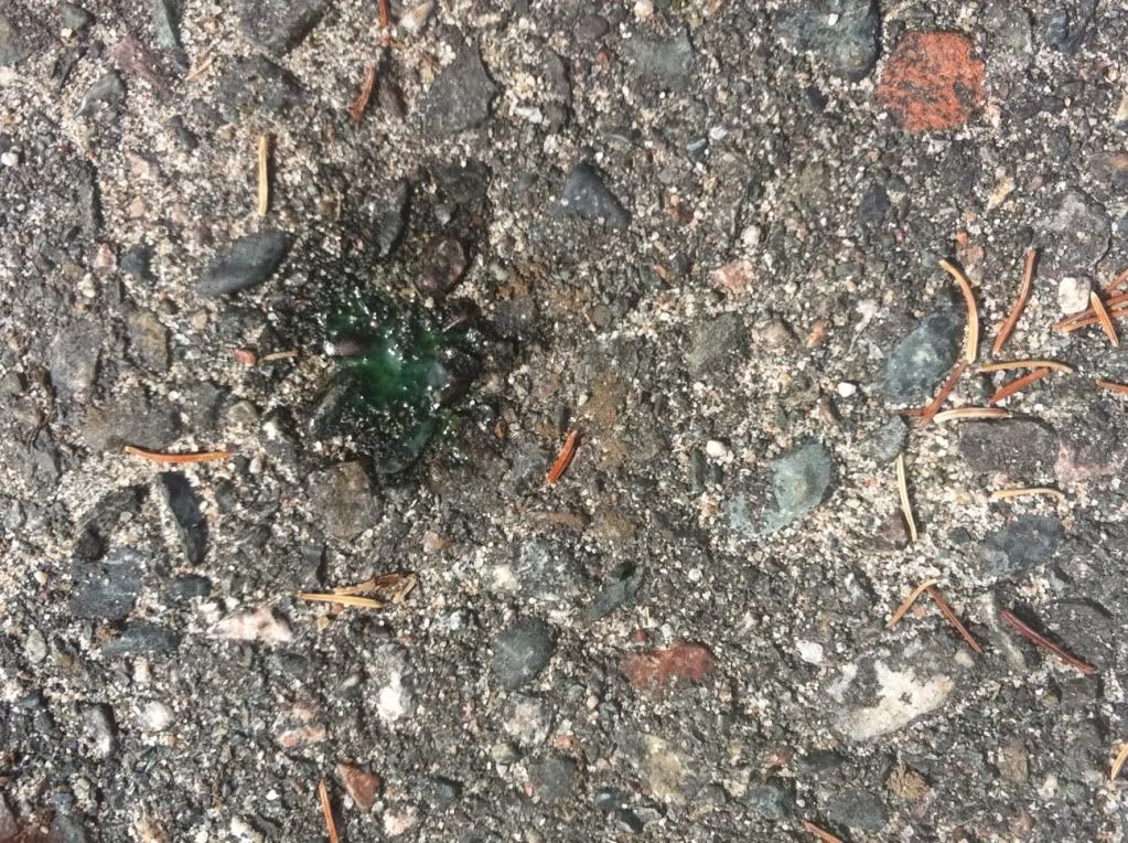

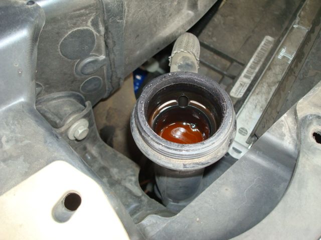

Posts: 9418
« Reply #70 on: May 06, 2013, 09:53:23 AM »
Thats not coolant...
Unless you did a drain and refill and put green stuff in.... and got rid of dexcool
The factory stuff is pink...
yours- may even be AC related...
Your stuff.
factory stuff..

« Reply #72 on: May 06, 2013, 02:17:03 PM »
I had this discussion this a.m with a rep from GM Canada, and I was told that the coolant could be green. I thought all Dexcool was red? I was wondering if anyone on here would notice after I posted the picture that the color was green, and I was referring to coolant.
Anyways it turns out my A/C is leaking and hopefully not my shaft seal as originally thought. ( lesser of two evils?)
I will find out when the dealership calls me to go pick up the verse.
Your stuff.
factory stuff..

« Reply #76 on: May 10, 2013, 08:40:54 PM »
GM calls for Dexcool antifreeze which is red, reddish, orangeish. Green coolant would mean it's not Dexcool , and would void the warranty. I think.
The green I thought was Dexcool was actually an oil dye that's added to the a/c system.
Hope this helps....
