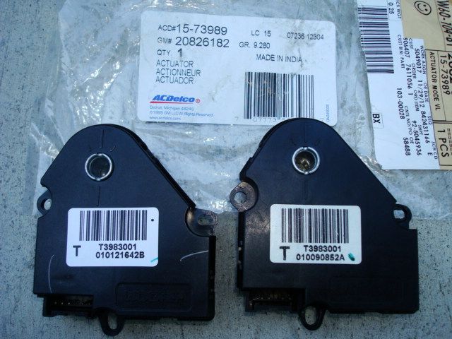

Posts: 9345
« Reply #9 on: October 28, 2013, 10:28:01 AM »
What is the part number for the hot/cold blend door actuator.  2010 with manual AC
from my HOW TO- thread
Got the replacement part.
Took me 25 min (with my 3 yr old getting in the way- 'helping me').
Problem resolved. Nice and quiet again. $38.xx for the part.
New part on the left.
Says made in India
Part number on the tag on the bag.
Unless the parts been updated.....

Hello again!
I'm sorry for the delay.  The part number that was provided to me is the same number that rbarrios posted earlier: Temp Valve Actuator P/N 20826182.  Please let me know if you have any other questions!

Posts: 9345
« Reply #17 on: October 30, 2013, 11:05:46 AM »
kbfisher....
sounds like your actuator- failed in the heat position/
so the blend door is now in the always hot position
You will have to remove the actuator and replace with a new one.
if youre handy--- this wil cost you about $30-$35 for the part on ebay or amazon.
