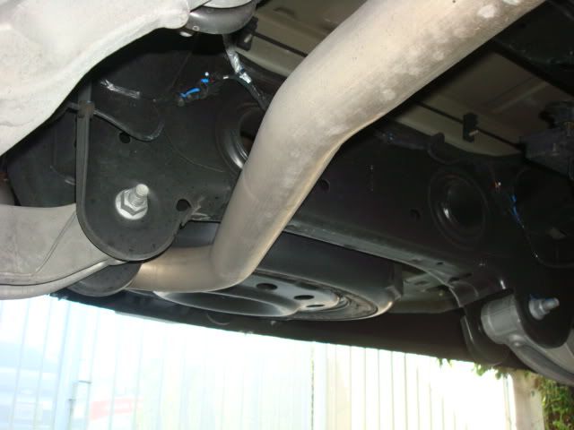

if you look at your rear and see the following--
you have FWD-- and NOT AWD
the AWD would have a shiny piece of metal with driveshafts going to each reat tire..
Posts: 9345
« Reply #4 on: October 03, 2012, 04:41:55 PM »
note the exhaust and muffler and the driveshaft and differential
