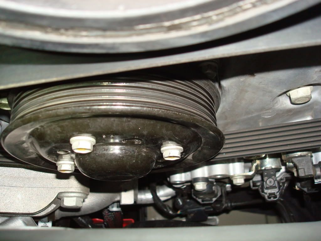

You can spot a slow leak by looking for signs of dexcool leaking and drying on the timing chain cover.
Heres an example- note the trail of dry coolant (white residue).
Another thing to look for is the signs of coolant being flung by the spinning water pump pulley.
Another sign to look for is drops of coolant that has not dried.
Another sign of the leak is a little more severe- drops of coolant on the floor. (the other spot was much bigger- about 8 inches wide).
This is only 1 drop
And- if you have a much bigger leak- signs of coolant on the vehicle.
here are shots-- with the wheel turned outward-- you can clearly see coolant

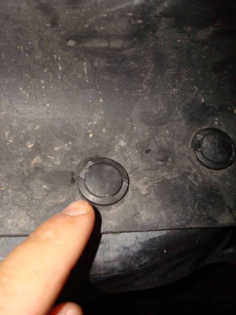

I went home and looked over the job-
I figured they had to somehow drain or suck out the coolant so it wouldnt leak when they removed the water pump.
there was no sign of a massive leak from the pump- from it being removed. But there was signs of coolant in the area below the radiator cap. (could be they overfilled? or some was spilled while removing it.... but this isnt of concern. Ive drained out coolant before and also end up with similar results. This will probably wash away with tommorrows rain). This is looking from the top of engine down.. and from the bottom looking up
To get to the radiator cap- they have to remove the big plastic shield. You can see the fasteners were removed.
This one took a little bit of damage. scuffs.
the pump installed. You can see the white sealant on the pump
So I always thought they removed the tire and wheel well liner completely to do the pump...But upon closer inspection of the fasteners...
theyre all dirty-- no signs of them being removed.

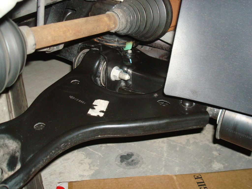

But I finally figured out how they did it. towards the bottoms- theres a piece of plastic that is bent... these fasteners showed signs of being removed
So it appears that if the vehicle is on a lift--- the person working from undeneath- can remove these fasteners- and have access to the pump.
(I think if youre at home-- you would have to remove tire and wheel well--- or remove tire and sort of follow their example of loosening the flap).
In this shot- you can see that theres signs of the Lower A-Arm getting 'cleaned'-- proabably by their shirt as they performed the repair. (leading edge).
I then sprayed a little simple green- and wiped down the area- so that I can have a reference- in case more coolant leaks.
