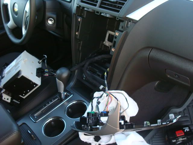

I have a clue on how to remove the vents...
see my pic below.. removing the bezel for the radio is quite easy... you wont need to remove radio...(but if you do- its only 4 screws and it slides right out...I pulled on the bezel carefully and it pops off...
But the following are from kevin 07xr on the outlook forum- a member who added Nav to his Outlook.
But looking at my pic and the pics for removing the bezel off an OUTLOOK...
you see what I see??? especially the last pic ( I didnt use a took to pull off bezel- just used fingers and light pulling)
Posts: 9211
« Reply #9 on: March 31, 2011, 01:27:17 PM »
on the outlook the vent cover is part of the front bezel.
on the traverse the bezel comes off with out the vent bezel.
but chances are you may just need to pop that off--- and possibly remove the top storage compartment...
But if you were able to remove the blower motor-- I think youll be able to remove the cover by a little eyeballing...

Thanks for the pics.  I had the front bezel off and the radio out the other day and saw three tabs on the bottom of the vents to snap off but I think I need to get the top compartment out first and then it might pop off.  I'm going to try tomorrow night or this weekend, I'll keep you updated!!
