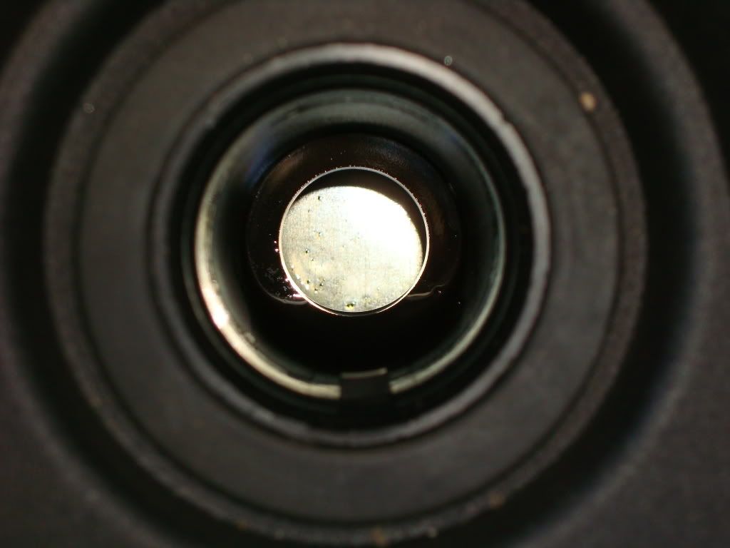

BEFORE your open you OIL fill cap... put your face up to the cap- close your eyes and blow at the lid...
Or use one of those Air in a bottle cans used to clean keyboards... You want to blow out alot of the very fine sand that accumulates around the filler cap- if not-- stuff will fall in as you remove the cap (this was not a problem on my other car) I just happened to look in and see....
(I stuck a napking down there to try to remove this)... but this is not good to have happen often...can you see the particles down there???
Those came from me opening the cap... (theyre not metal particles)

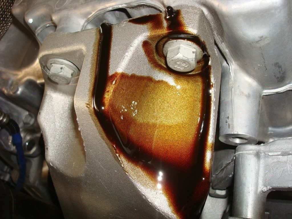

But now looking at this pic--- why does the oil still come down like this?
But this is actually BETTER than having the vehicle pointing in the other direction- since my previous 2 oil changes- oil was coming from other places too. (the oil is dripping down-- note the oil drops forming at the top of the pic- I took pic- looking UP at engine)

I looked from the top- to try to figure out why the oil drips down like that---

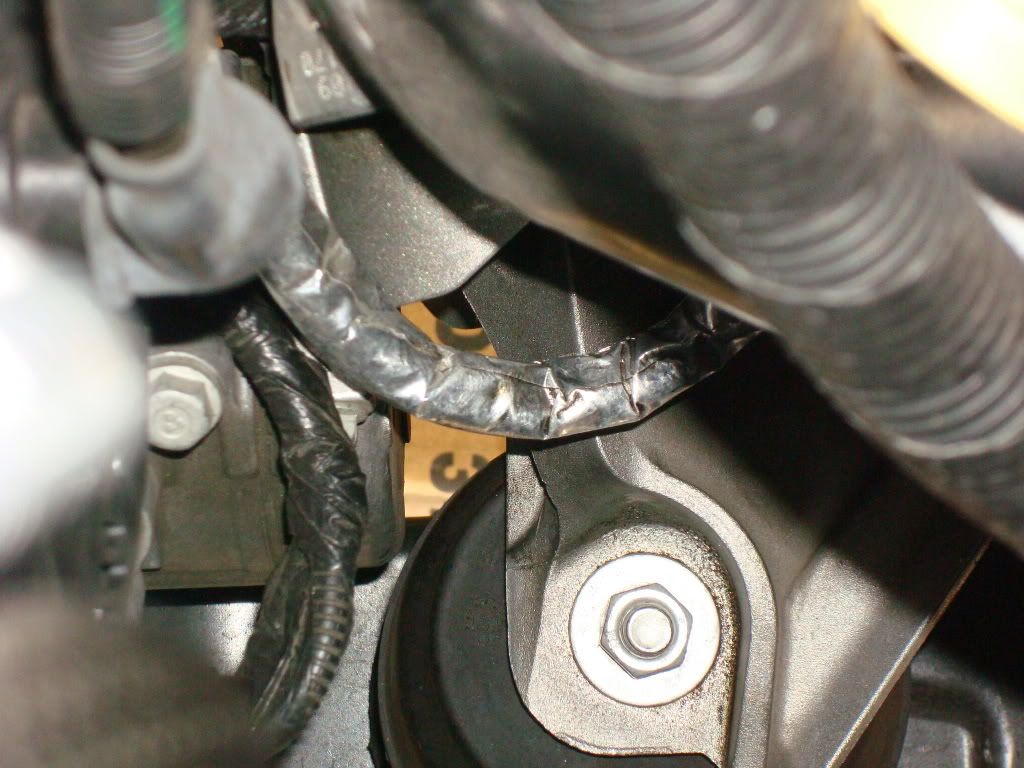

turns out theres a cable in the way- as oil comes out of the oil filter-- it falls on this cable- and well causes it to go where it shouldnt.
In this pic- I moved it forward. but it was originally further back- right under the falling path of the oil...
Next time Im about to drain the filter---- Im going to place the cable- in the position it is in the picture.
Hopefully this allows the oil to drain straight down and into the pan...
note the oil residue on the cables foil cover. the oil should come out of the filter and into that metal tab- and straight down- down to where you see the cardboard (pan was there).. but instead- it 1st hit the cable and then made its way down.
